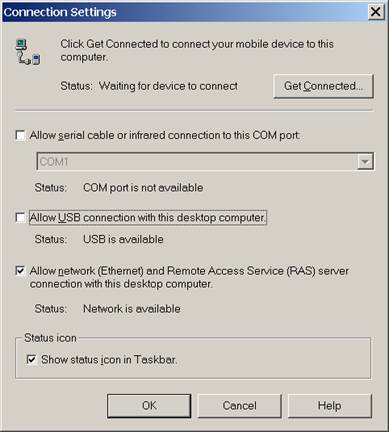

1. You MUST use the serial
cable connection with the cable attached to COM1 on the Allegro. You MUST
disable ActiveSync from using the serial port on your computer. Go into the
ActiveSync window and click the File/Connection Settings menu item and UN-CHECK
the "Allow serial cable or infrared connection to this COM port" box.

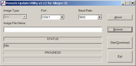

3. On your desktop
computer, using a file explorer, navigate to the file "RemoteUpdate.exe ". It should be in the folder you extracted the
zip file to. Run the Remote update
utility following the steps below:
a.
Double
click on this “RemoteUpdate.exe” to run it.
b.
The
"Remote Update Utility" screen is shown asking you to set the
communication parameters for the computer Com port and the baud rate.
c.
Set
the communication port setting for the port that the serial cable is connected
to on your desktop computer. (This setting is NOT referring to the Allegro COM
port; it is referring to the serial port on your computer.)
d.
Set
the Baud Rate to 115,200.
e.
Click
the Browse button and locate the Boot.bin file. Click
on the file name “Boot.bin” and then on the Open
button.
f.
Click
on the "Start Download" button in the Remote Update window.

8. If you normally connect
to your Desktop PC using the serial port, go back into ActiveSync
"Connection Settings" menu item and check the check box to enable
"Allow serial cable or infrared connection to this COM port".
